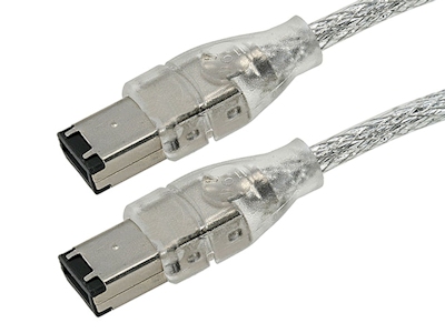

What kind of Firewire cable do I need?

This is what I use: 6 pin to 6 pin
